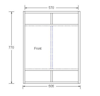

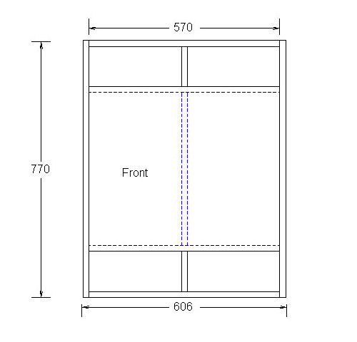

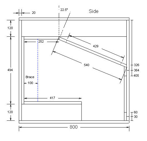

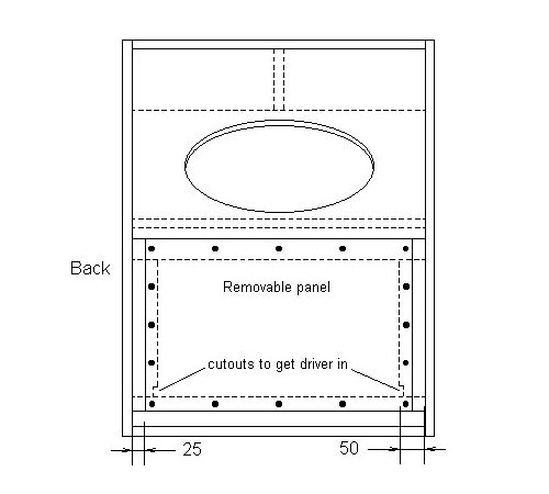

uite un proiect
poza
 Filesize:  28.18 KB
 Viewed:  238 Time(s)
 Filesize:  31.61 KB
 Viewed:  237 Time(s)
 Filesize:  22.7 KB
 Viewed:  240 Time(s)

samy , sterge ultimul tau post ca induci grav lumea in eraore , ce ai prezentat tu e un proiect pentru un dif pro!!!!!!!!!!!!!!!!!!!!!!!!!!!!!!!!!!!!!!!!!!!!!!!!!!!!!!!!!!!!!!!!!!!!!!!!!!!!!!!!!!!!!!!!!!!!!!!!!!!!
