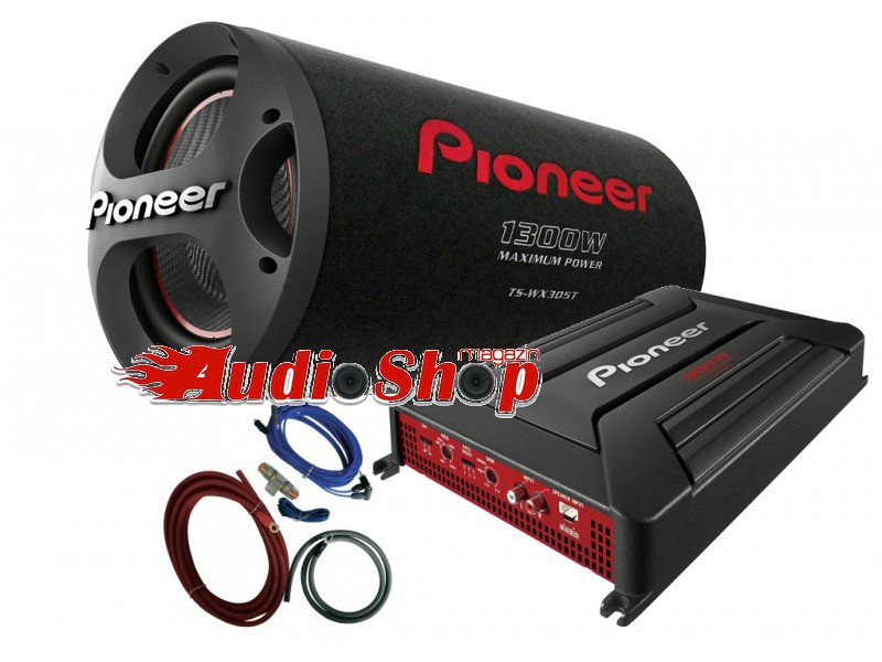

am nevoie de o parere se merita.... vreau sa achizitionez pachetul asta Amplificator Pioneer GM-A5602 Subwoofer Pioneer TS-WX305T....
 Filesize:  88.01 KB
 Viewed:  325 Time(s)
