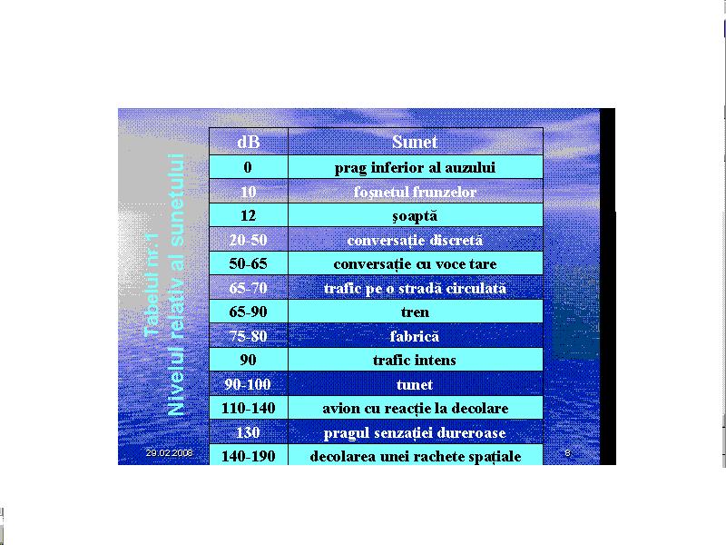

Sa inteleg ca suna a si o racheta la decolare ?? nu prea cred Very Happy
 Filesize:  88.49 KB
