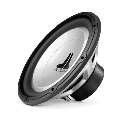

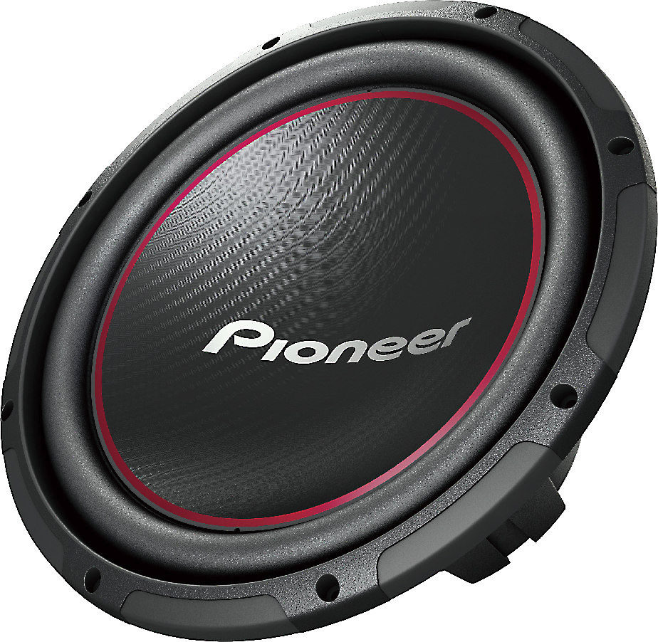

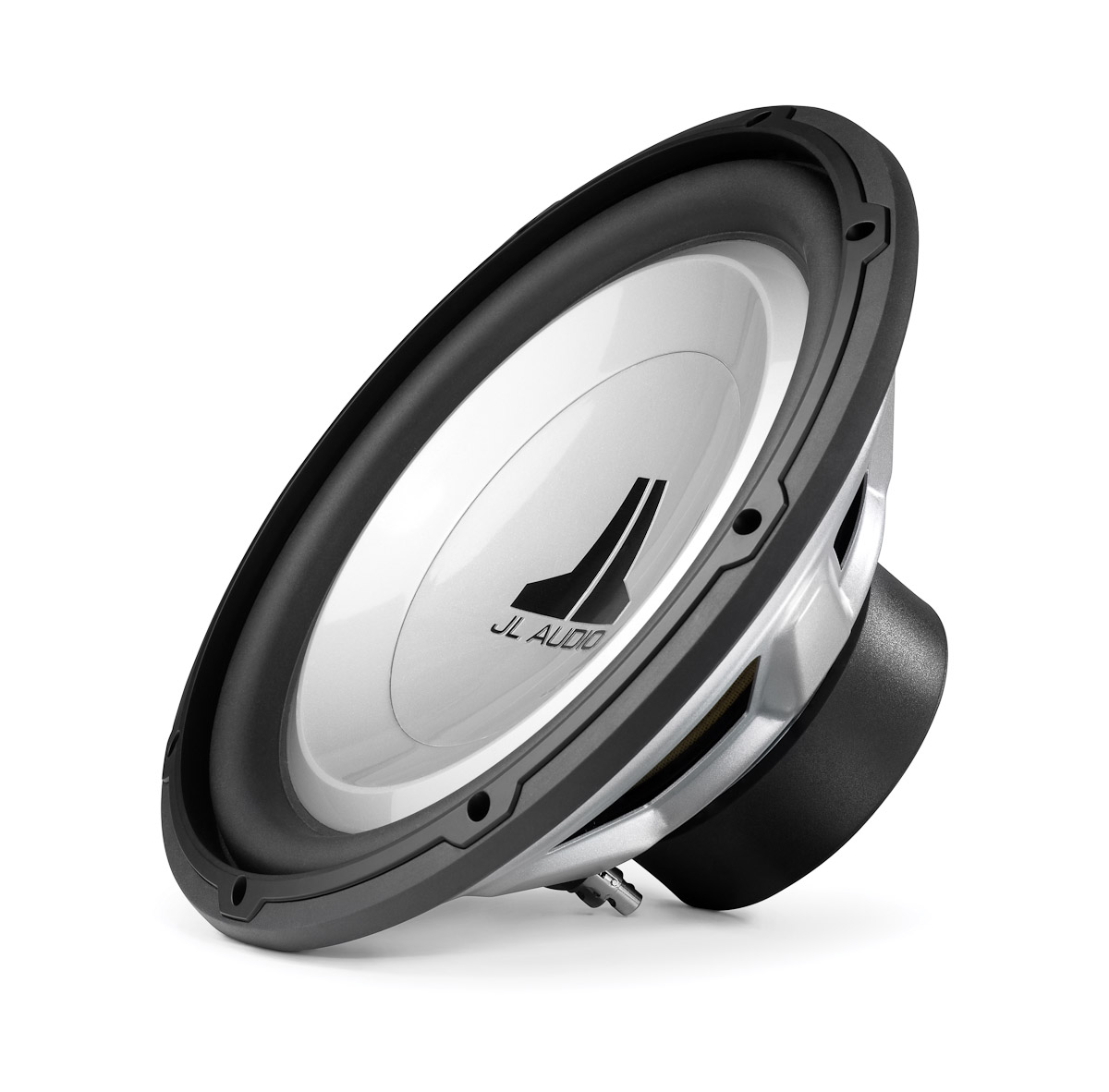

Am de ales dintre doua woofere pentru o incinta din fibra de sticla.
Vreau sa o fac reflex si nu stiu care woofer ar fi mai potrivit dintre urmatoarele doua (am nevoie de niste opinii sau daca aveti alte idei de woofere pana in 250 de lei):
JL - 12W1v2-4
Free Air Resonance (Fs) 23.68 Hz
Electrical “Q” (Qes) 0.443
Mechanical “Q” (Qms) 6.465
Total Speaker “Q” (Qts) 0.414
Equivalent Compliance (Vas) 3.739 cu ft / 105.81 L
One-Way Linear Excursion (Xmax)* 0.375 in / 10 mm
Reference Efficiency (no) 0.304%
Efficiency (1 W / 1 m)** 86.81 dB SPL
Effective Piston Area (Sd) 81.392 sq in / 0.0525 sq m
DC Resistance (Re) 4.101 Ω
sau
Pioneer TS-W304R
Maximum input power 1.300 W
Nominal input power 300 W
Impedance 4Ω
Frequency response 20 - 220 Hz
Sensitivity (1W/1m) 95 dB
Woofer size 30 cm
Woofer material IMPP cone
Voice Coil bobbin type Extended and Vented pole yoke
Cut-out Hole 283,0 mm
Mounting Depth 134,5 mm

Eu as alege JL AUDIO...Bafta!!!!!!

Diful. Pioneer are EBP sub 50, deci va da rezultate doar in incinta inchisa; JL-ul poti sa-l folosesti in incinta bass reflex, dar tot o incinta inchisa i s-ar potrivi mai bine.
