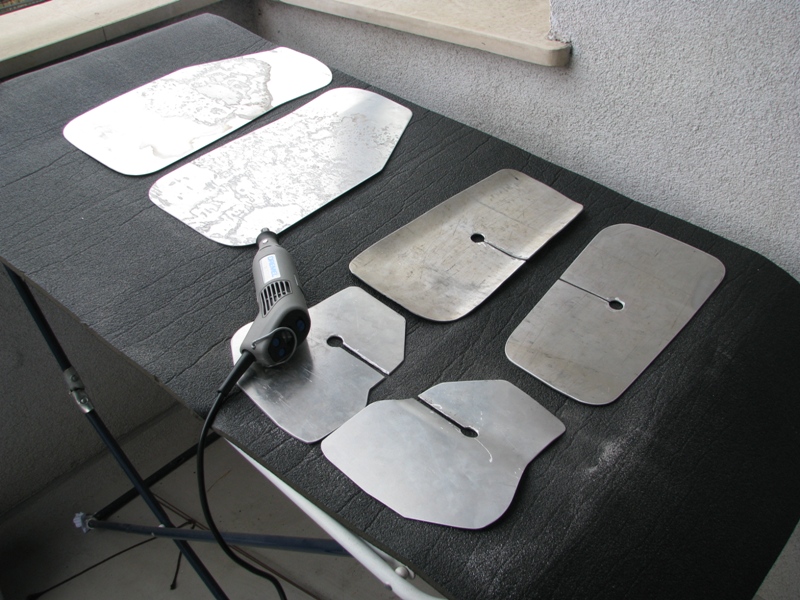

A trecut si 1 Decembrie asa ca am mai facut ceva la masina

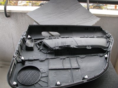

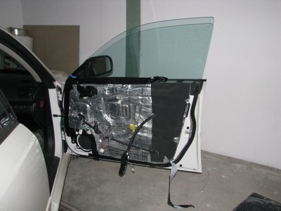

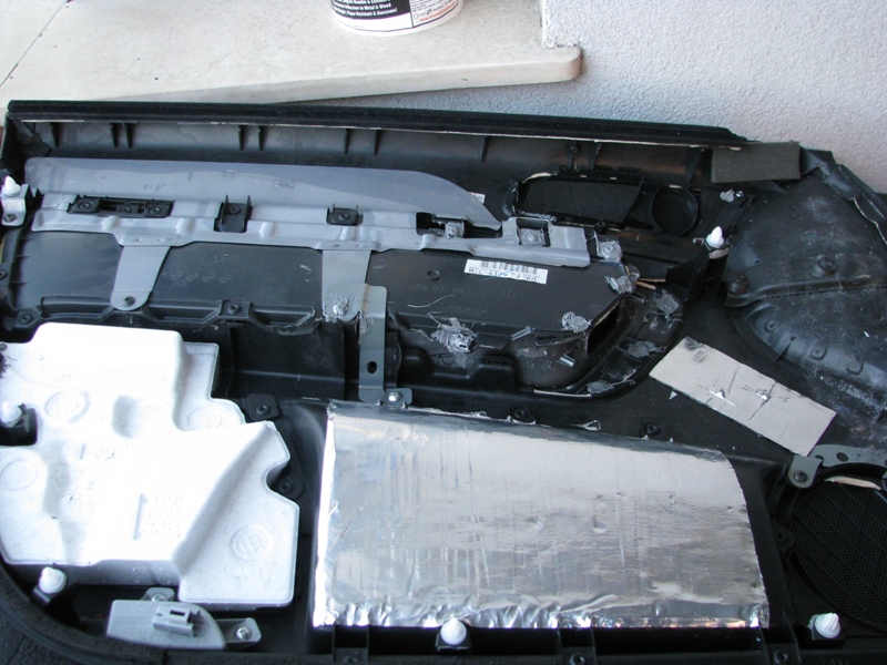

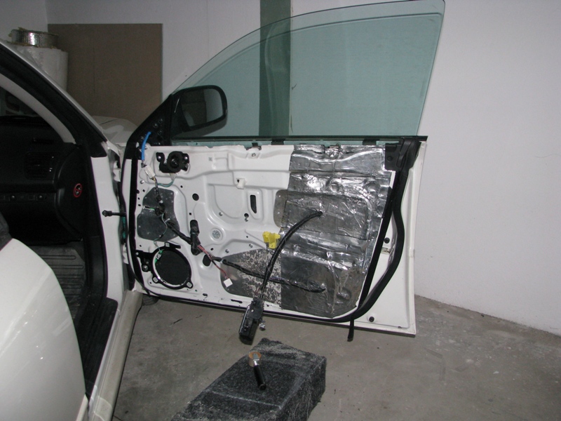

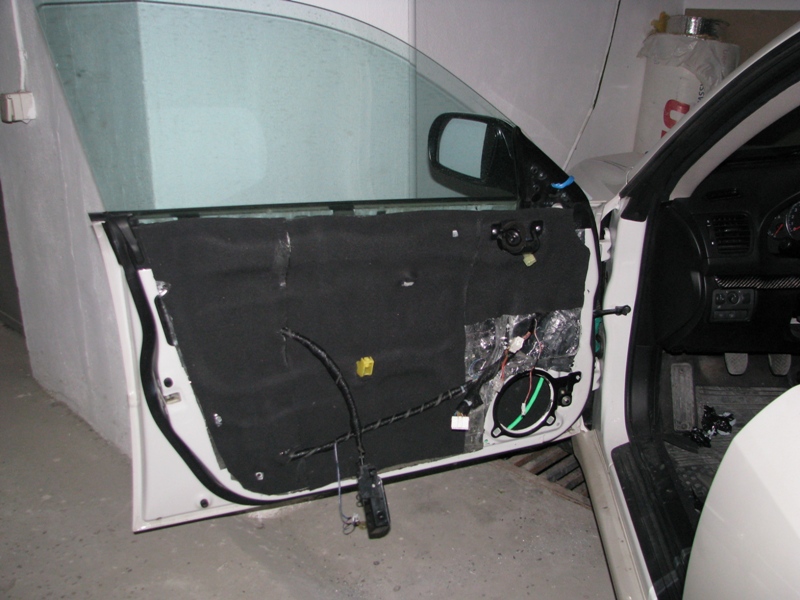

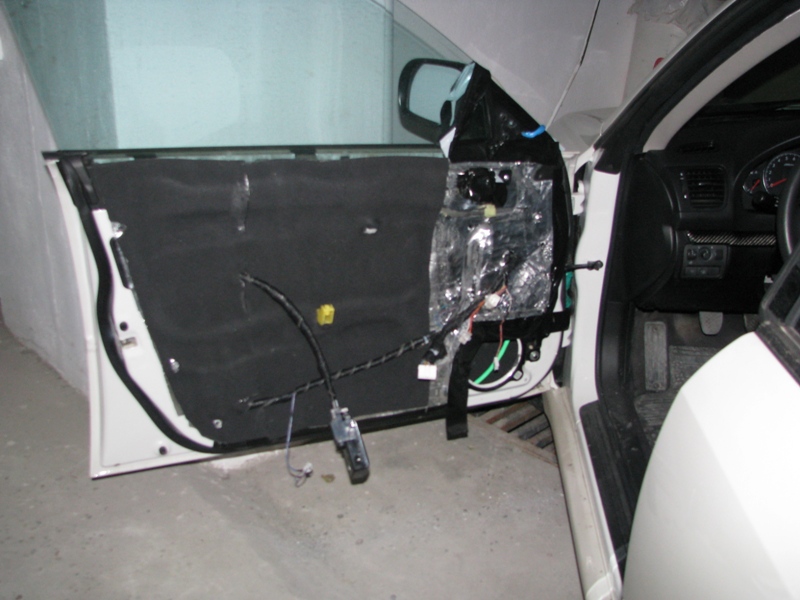

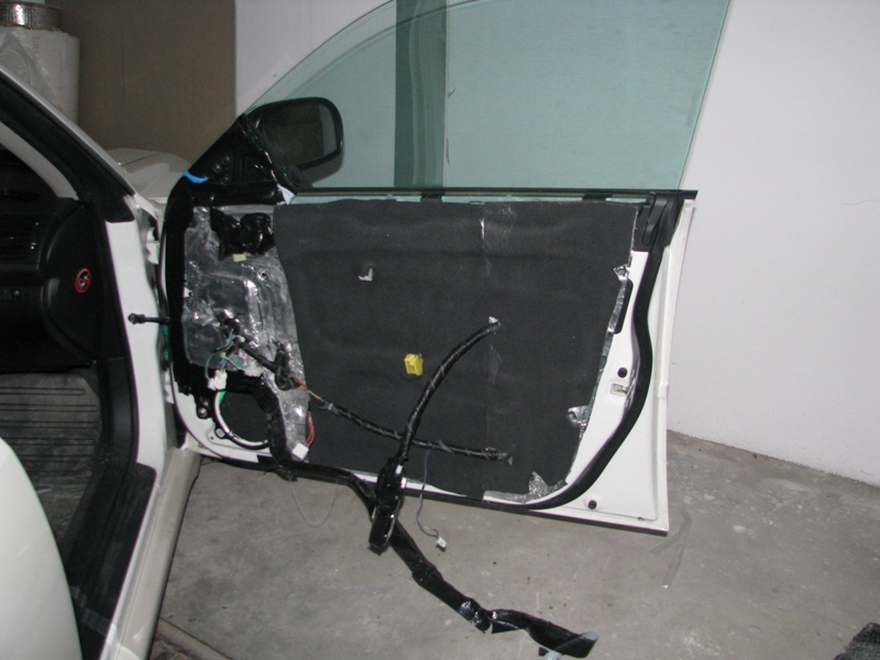

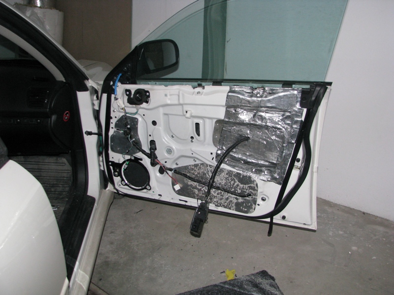

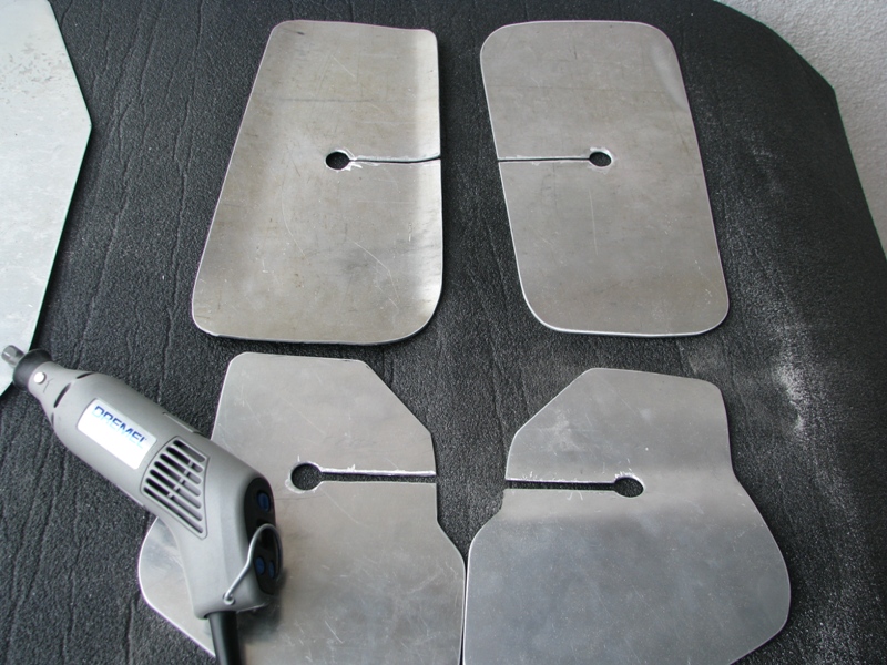

Am continuat cu Spectrum pe fetele de usi si peste Rattlepad iar pe urma in garaj cu imbracarea cablurilor cu Rattlepad.

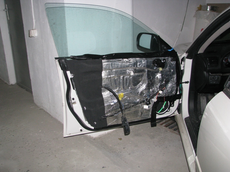

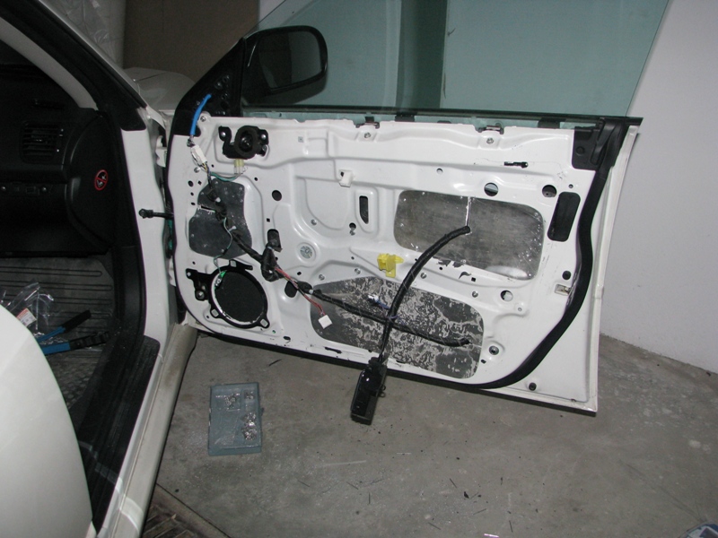

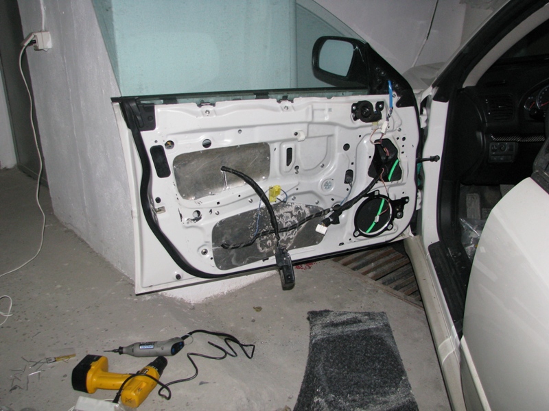

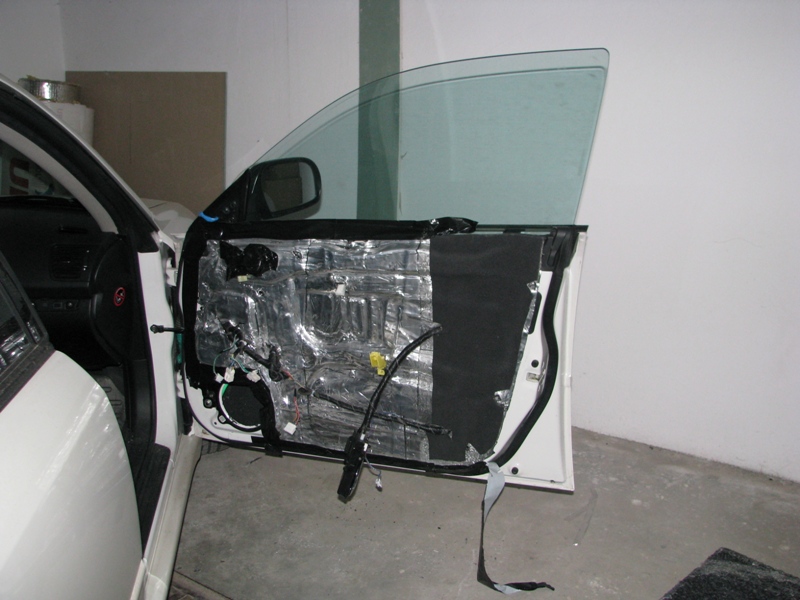

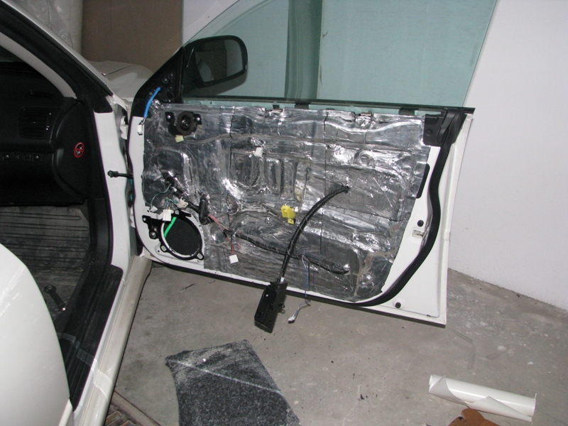

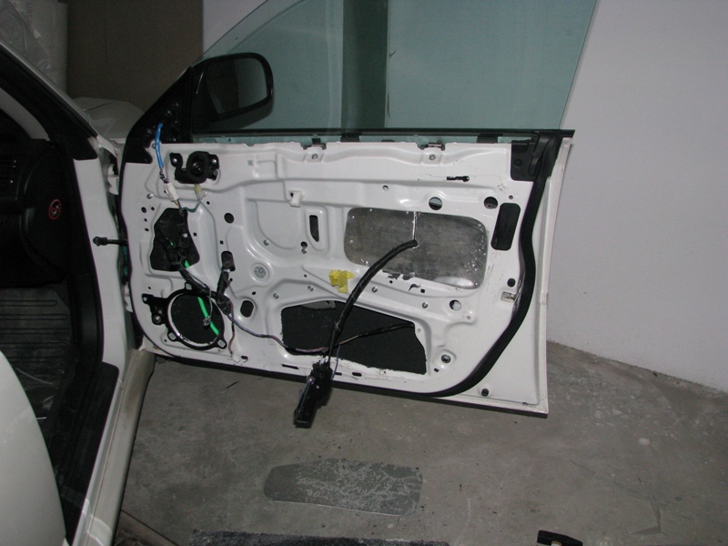

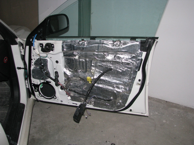

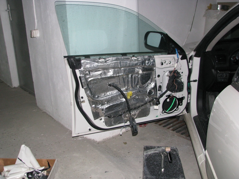

Usile din fata:
 Filesize:  224.06 KB
 Viewed:  383 Time(s)
 Filesize:  187.13 KB
 Viewed:  404 Time(s)
 Filesize:  197.4 KB
 Viewed:  378 Time(s)
 Filesize:  200.15 KB
 Viewed:  407 Time(s)

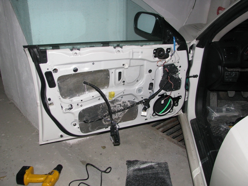

faibox
Data înscrierii: 12/Mar/2007
Mesaje: 350
Locație: Tulcea
MesajTrimis: Lun Dec 14, 2009 5:54 pm    Titlul subiectului: Răspunde cu citat (quote)
Cum ai prins acele tablite?
Cu nituri?
Addicted to Bass
TAZMANIA
Data înscrierii: 12/Noi/2007
Mesaje: 313
MesajTrimis: Lun Dec 14, 2009 7:35 pm    Titlul subiectului: Răspunde cu citat (quote)
Da, cu nituri
Initial am vrut cu suruburi dar dupa ce am vazut cat de usor le pot scoate am renuntat la suruburi.

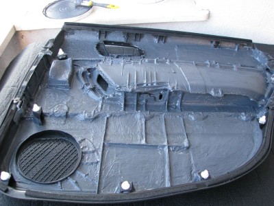

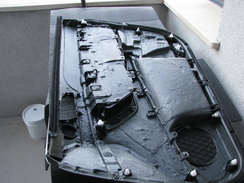

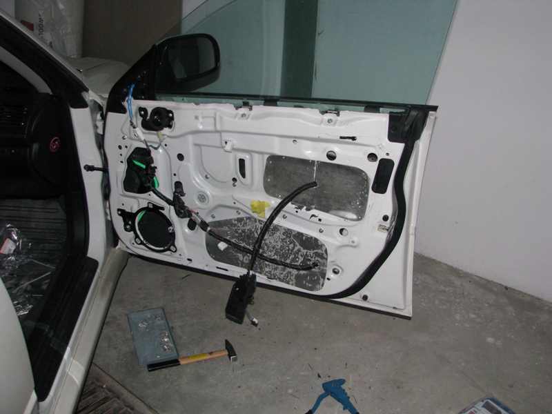

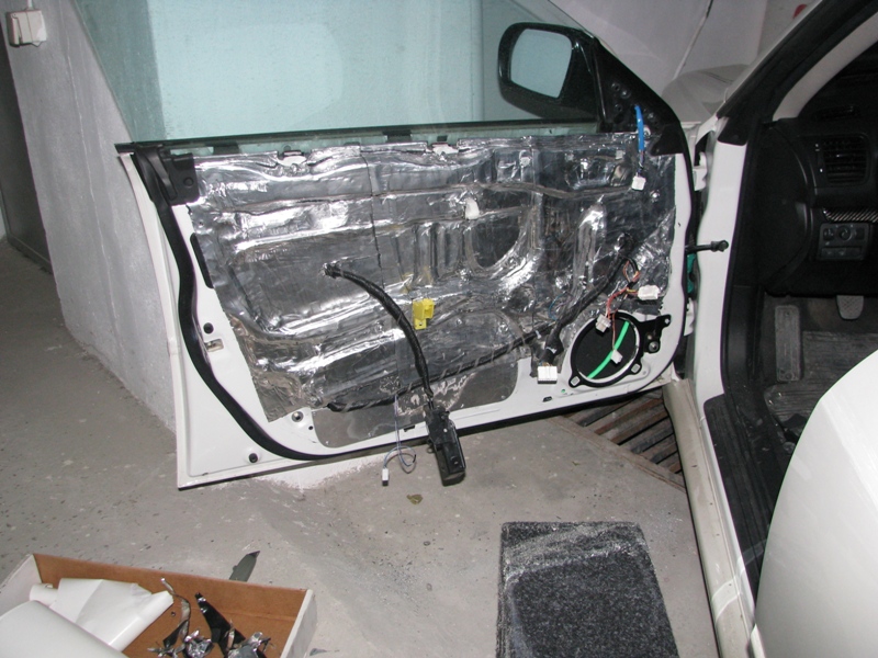

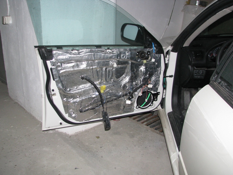

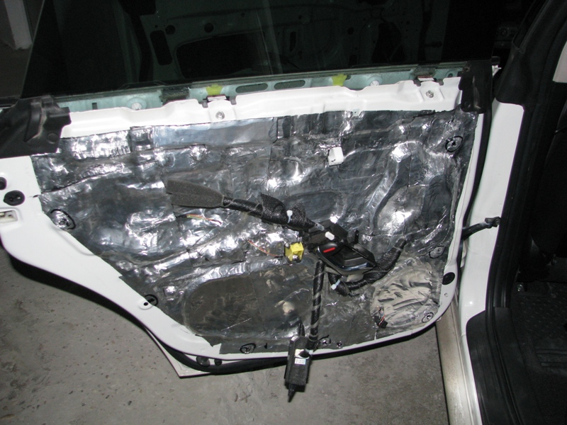

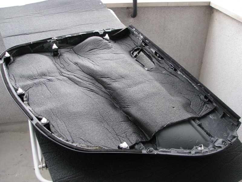

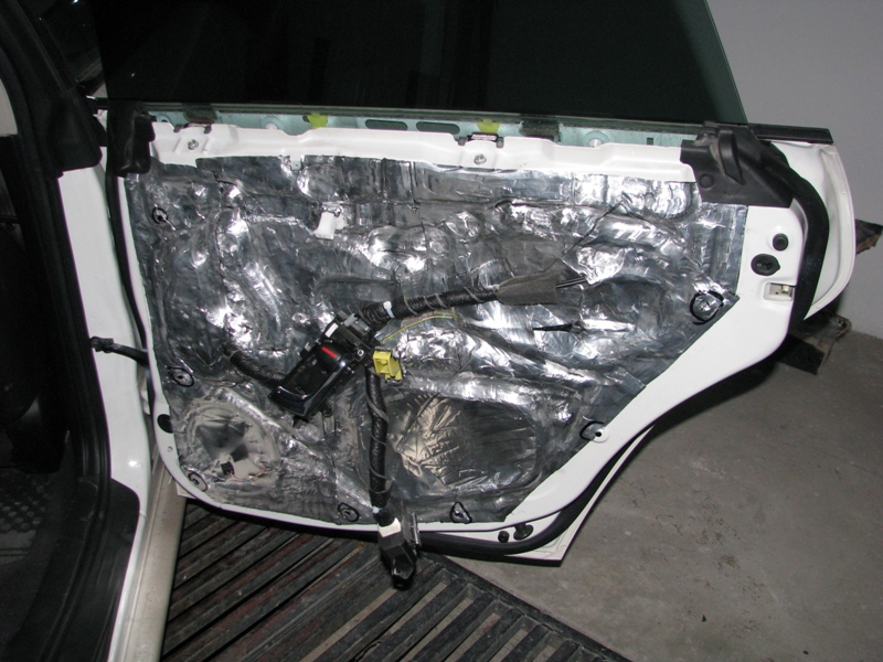

Am terminat si cu antifonarea usilor Laughing
Usa din stanga a avut exact acelasi tratament ca cea din dreapta:
 Filesize:  207.74 KB
 Viewed:  360 Time(s)
 Filesize:  212.66 KB
 Viewed:  374 Time(s)
 Filesize:  214.61 KB
 Viewed:  363 Time(s)

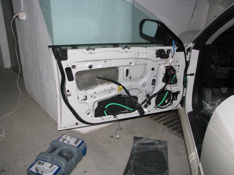

A urmat Damplifier Pro:
 Filesize:  198.58 KB
 Viewed:  364 Time(s)
 Filesize:  191.7 KB
 Viewed:  335 Time(s)
 Filesize:  209.21 KB
 Viewed:  348 Time(s)
 Filesize:  216.1 KB
 Viewed:  361 Time(s)

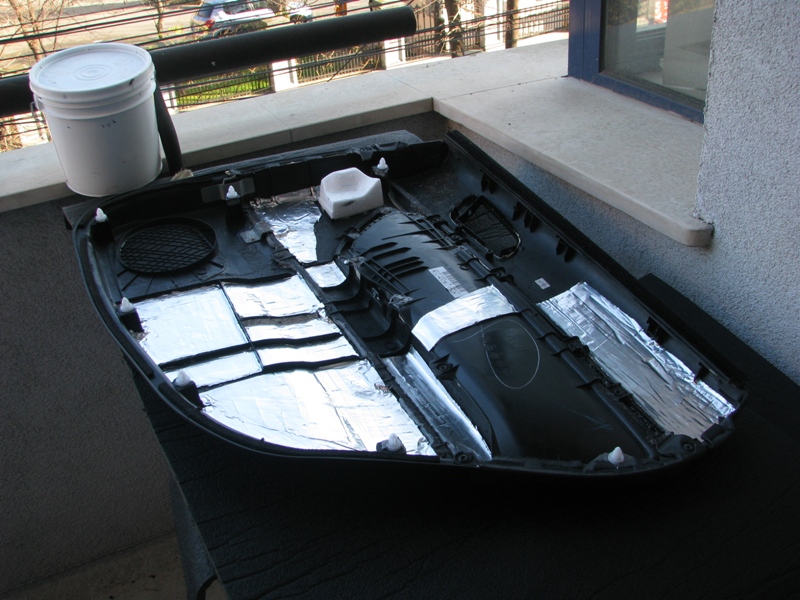

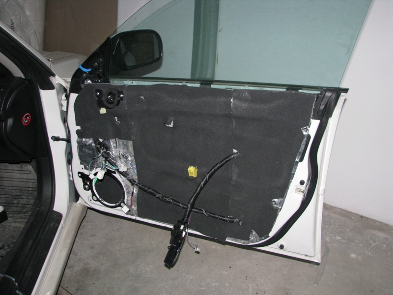

Si peste Overkill Pro:
 Filesize:  179.3 KB
 Viewed:  414 Time(s)
 Filesize:  176.41 KB
 Viewed:  438 Time(s)
 Filesize:  195.16 KB
 Viewed:  356 Time(s)
 Filesize:  202.9 KB
 Viewed:  345 Time(s)
 Filesize:  170.88 KB
 Viewed:  399 Time(s)
 Filesize:  189.97 KB
 Viewed:  346 Time(s)
