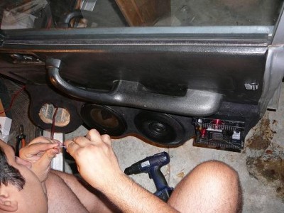

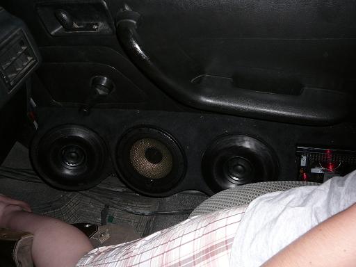

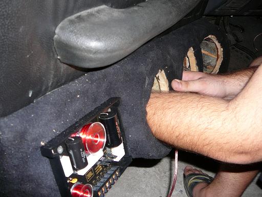

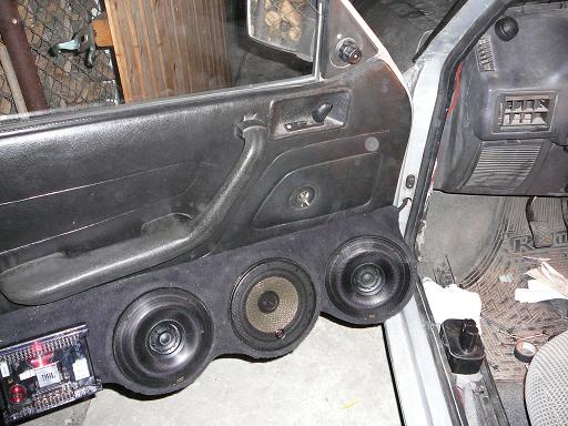

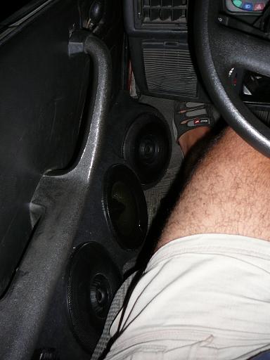

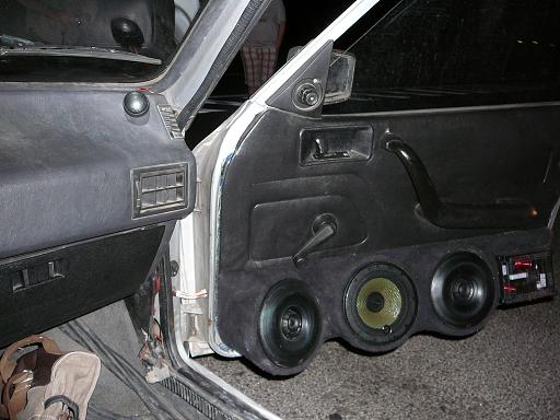

MesajTrimis: Dum Iun 24, 2007 4:00 am    Titlul subiectului: Răspunde cu citat (quote)

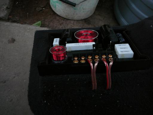

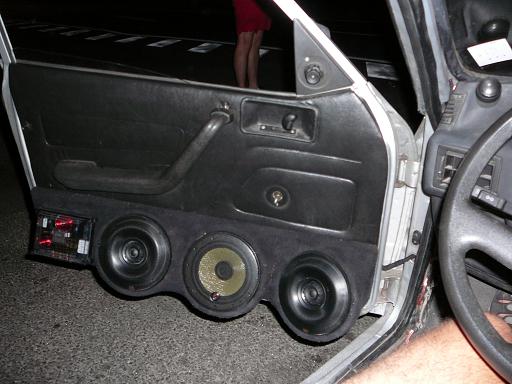

poze noi...
EMMA ESPL Ready Smile Twisted Evil
 Filesize:  31.89 KB
 Viewed:  363 Time(s)
 Filesize:  49.74 KB
 Viewed:  367 Time(s)
 Filesize:  60.88 KB
 Viewed:  406 Time(s)
 Filesize:  53.44 KB
 Viewed:  369 Time(s)
 Filesize:  50 KB
 Viewed:  389 Time(s)
 Filesize:  50.4 KB
 Viewed:  370 Time(s)
