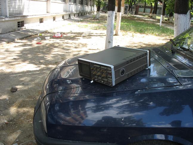

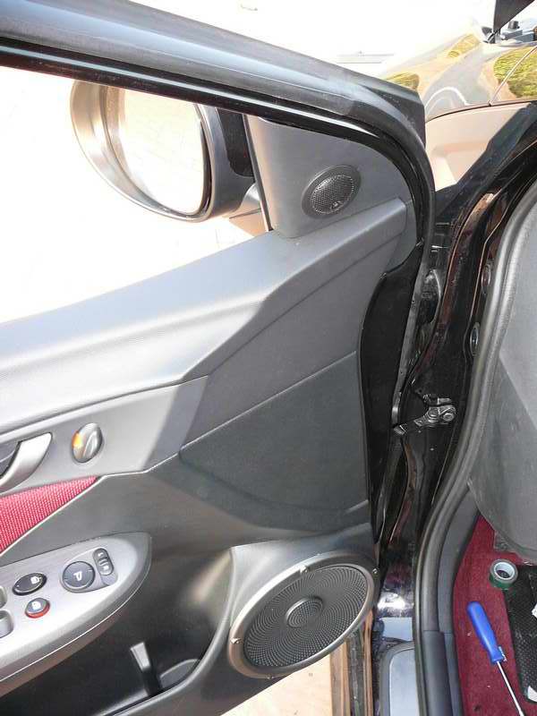

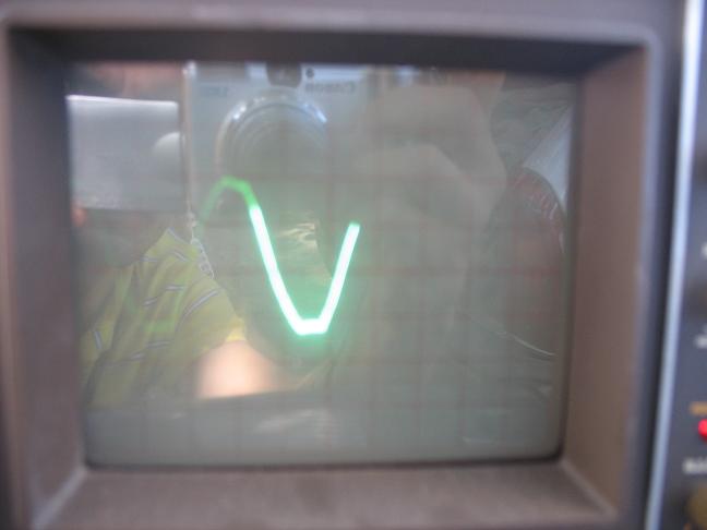

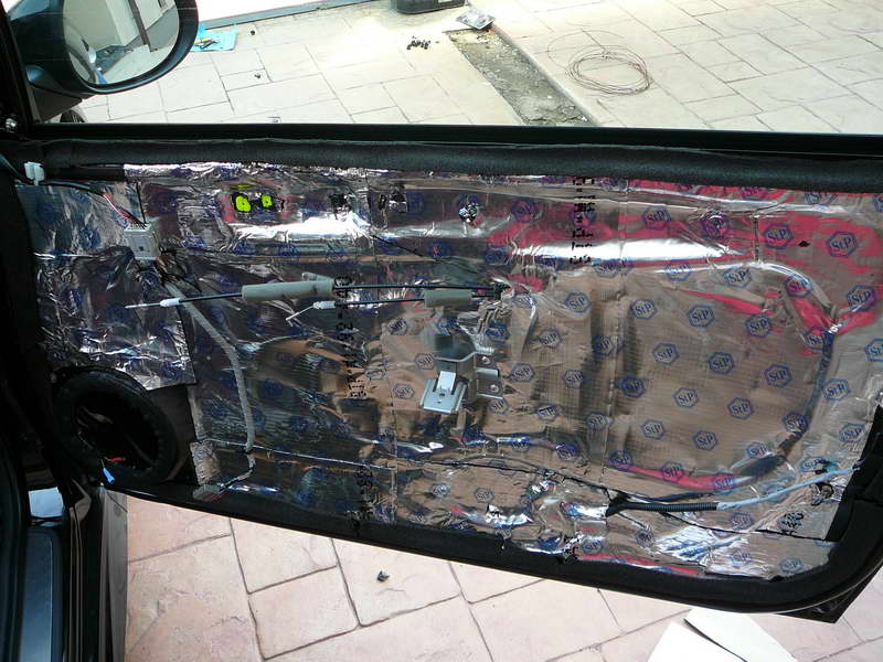

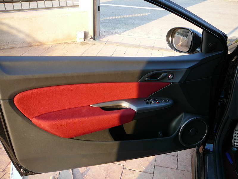

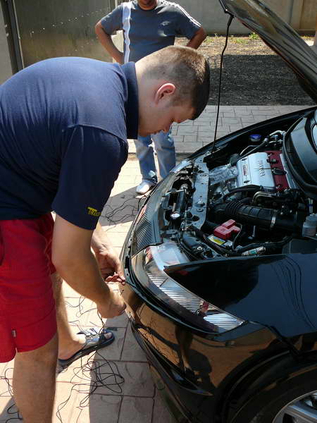

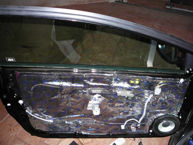

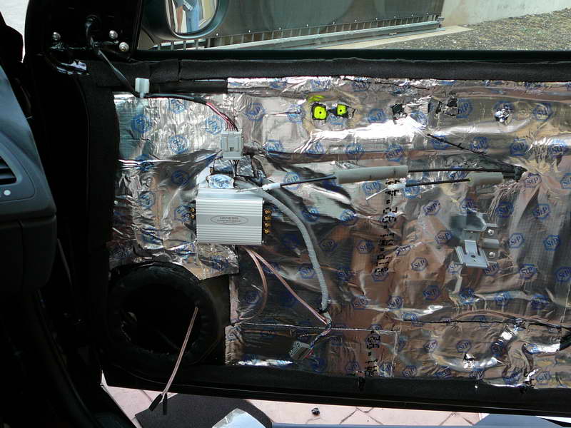

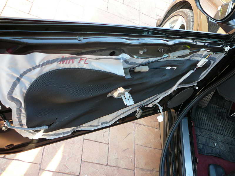

Astazi s-a recurs la reglarea amplificatoarelor cu un osciloscop, deoarece la puterile respective distorsiunile sunt foarte periculoase.
S-a reglat astfel incat la volum aproape de maxim distorsiunile sa fie 0.
midwooferele de la GZ au fost taiate HP , iar cele JBL taiate LP au fost puse in paralel, cate 2 pe un canal de amplif.

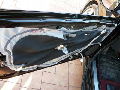

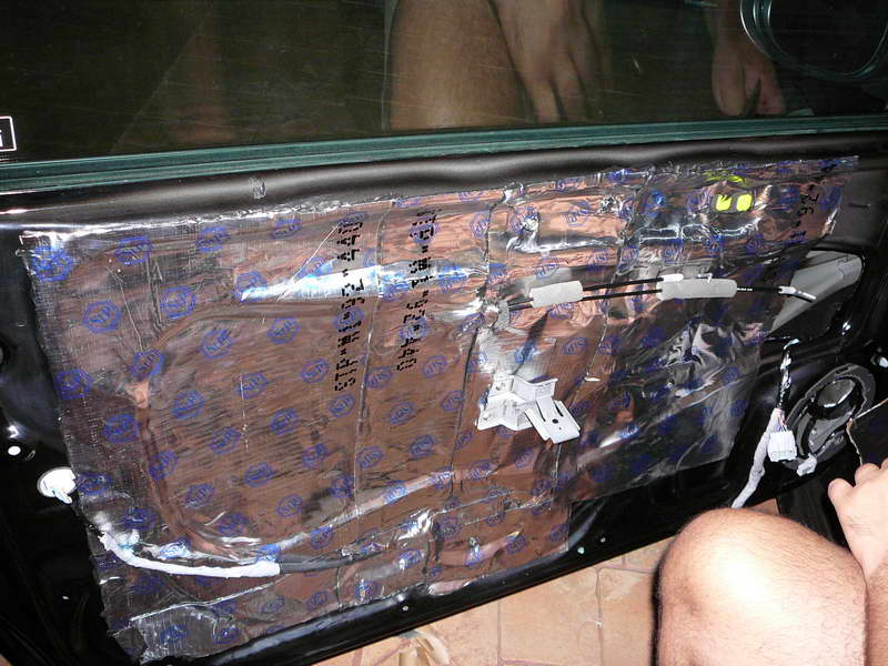

Usile se comporta exemplar, nu zbarnaie deloc, nici un zgomot enervant. Cateodata e bine sa ai masina veche cu fata de usa din carton Smile)
Claritatea sistemului este deasemenea una de invidiat.
mai pun cateva poze, mai inexpresive Smile

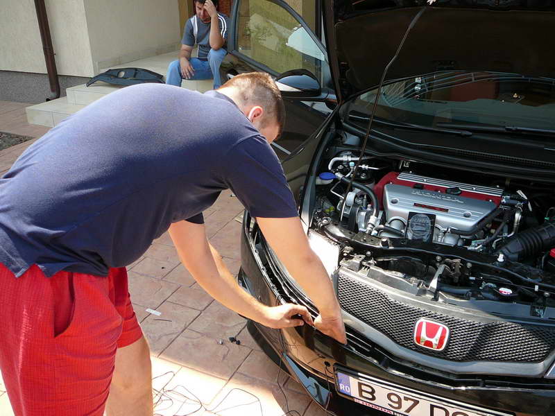

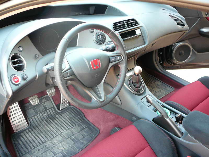

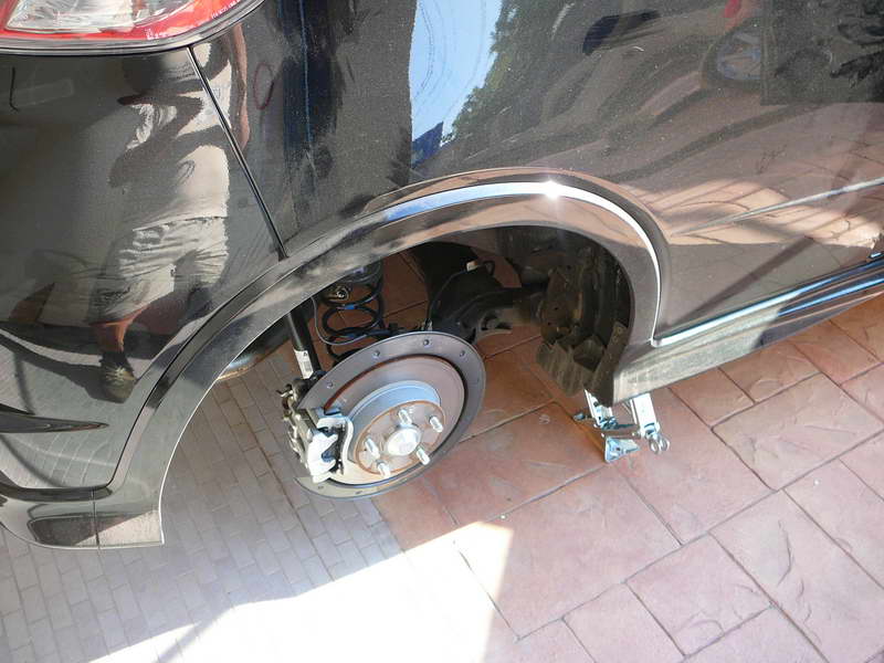

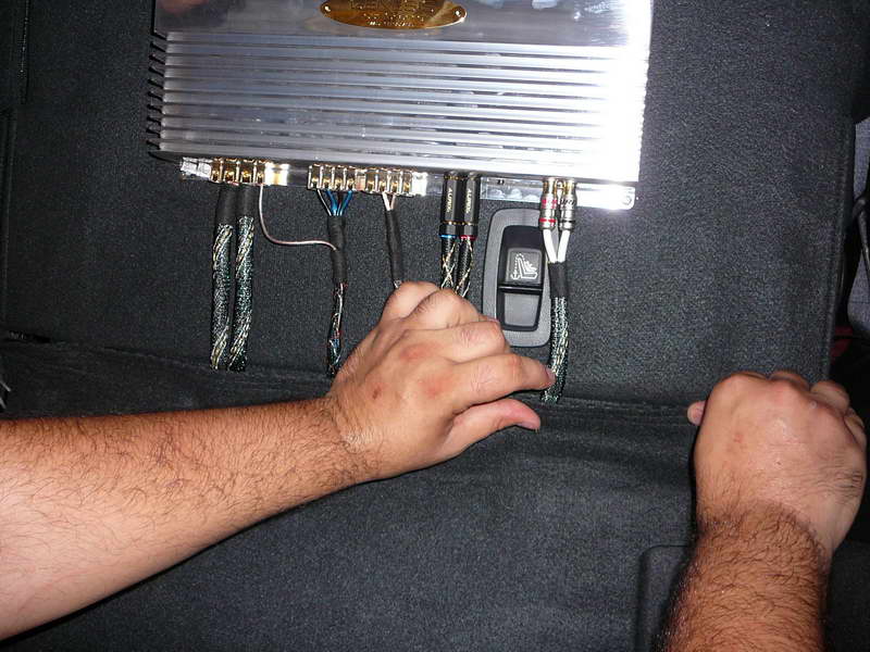

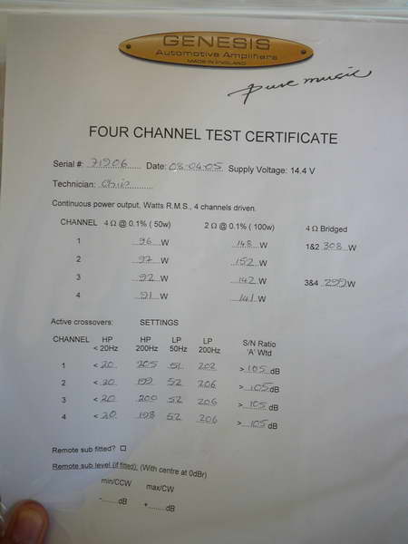

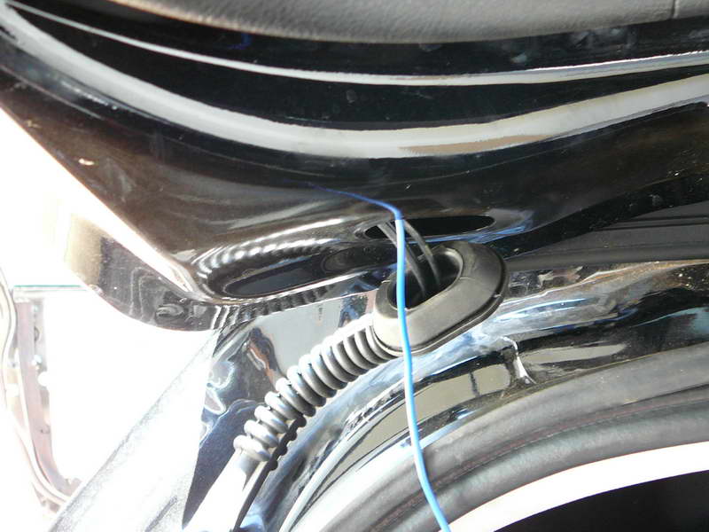

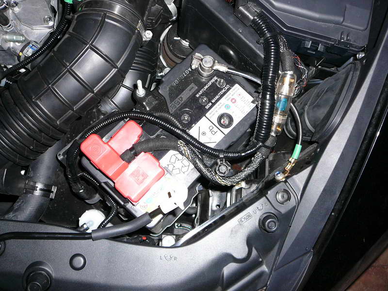

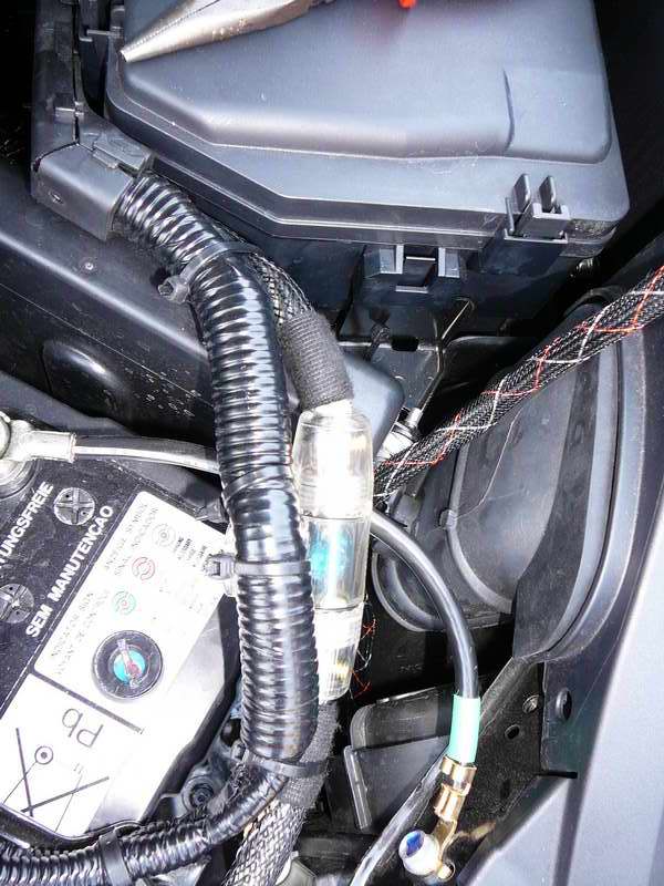

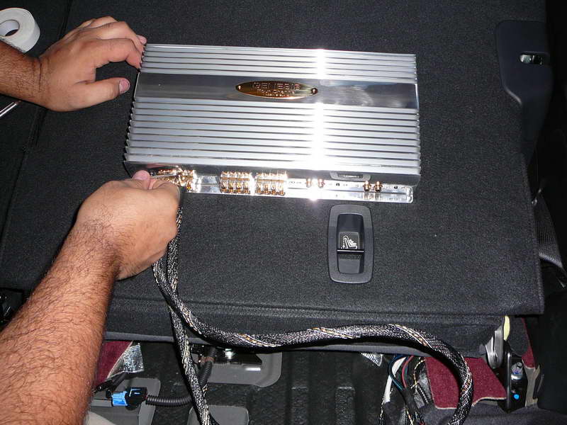

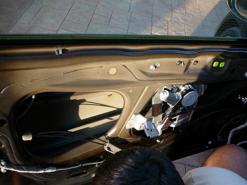

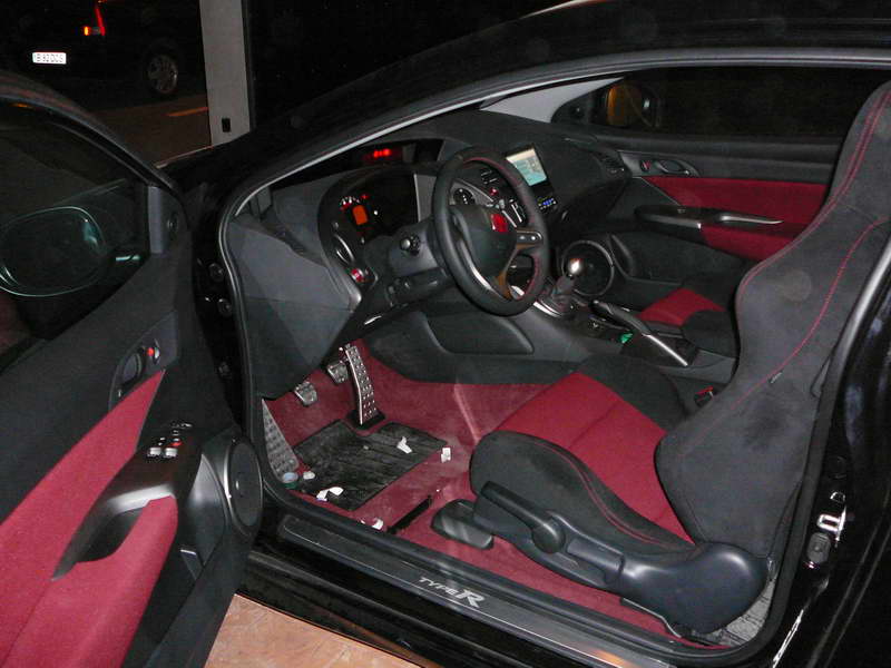

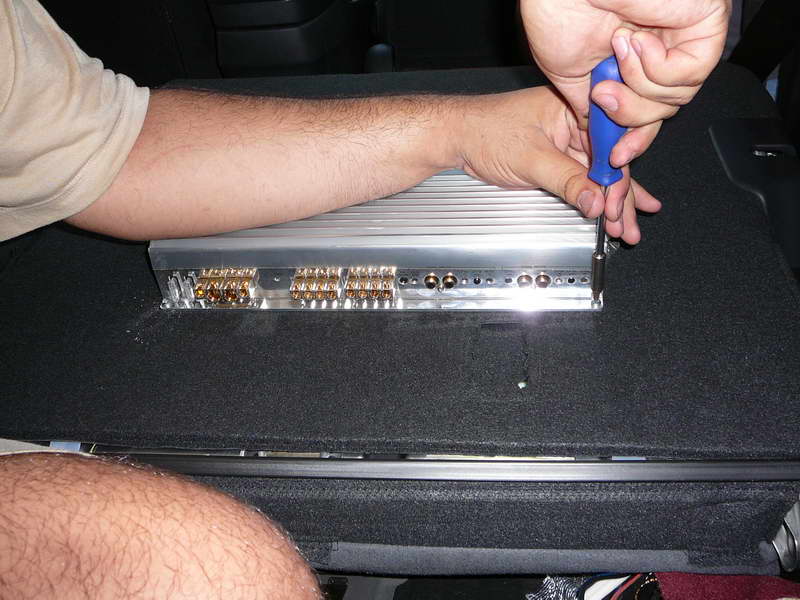

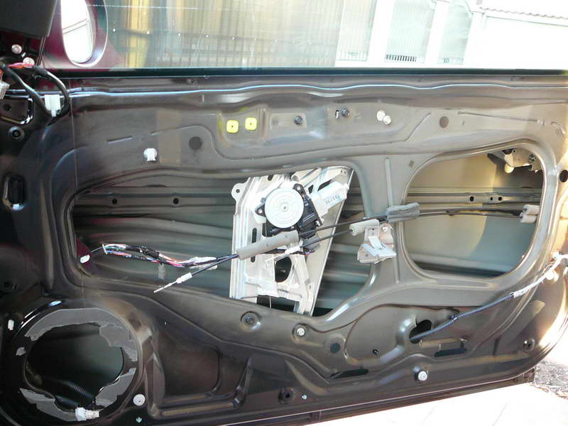

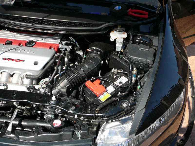

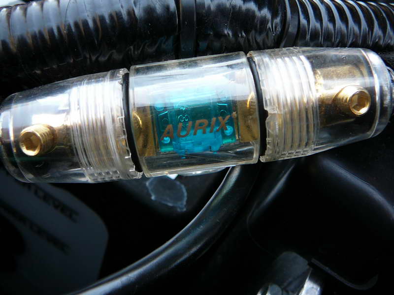

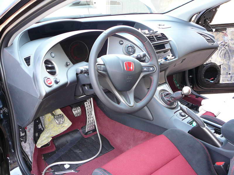

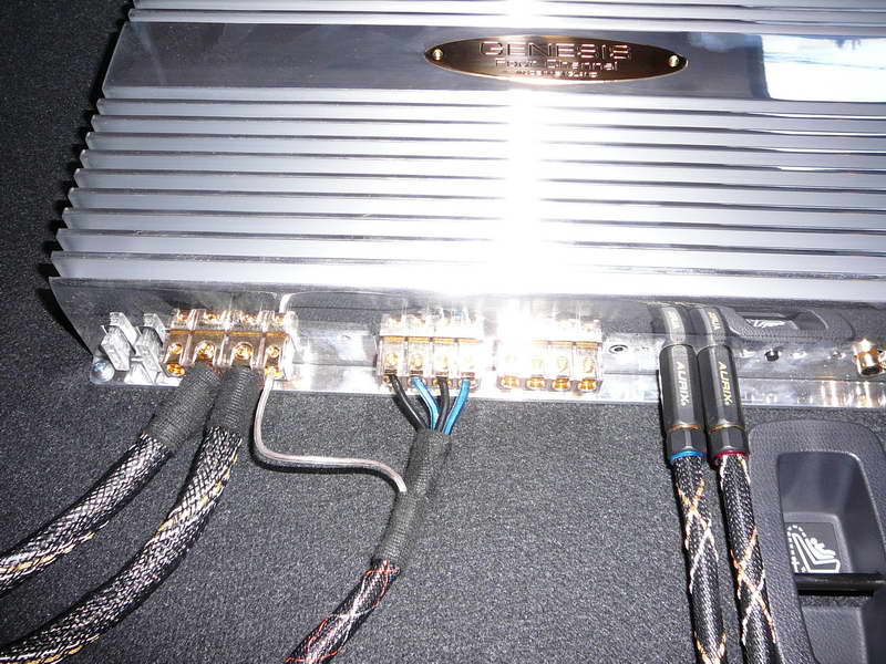

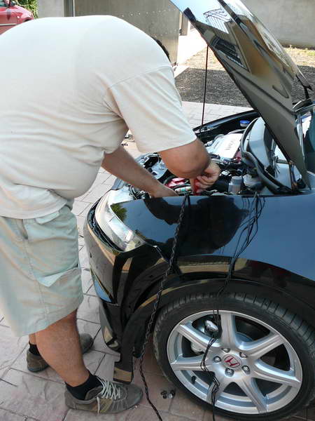

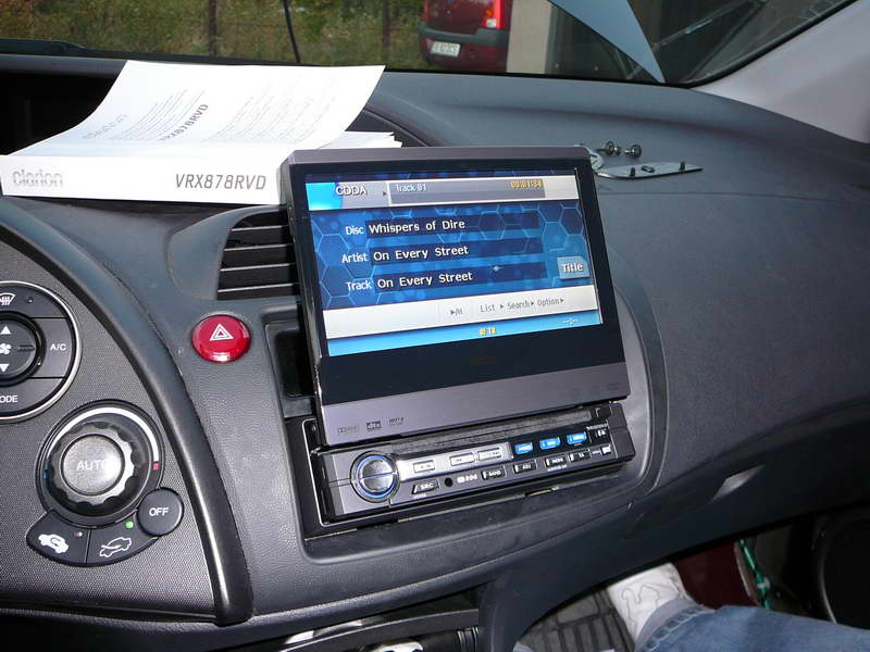

Latest install: 26-27 iulie 2007
Sau mai bine spus: Instalare Car Audio la domiciliu Smile
Masina: Honda Civic TypeR 2007 ( 500 km la bord Smile )
HU: Clarion VRX878RVD

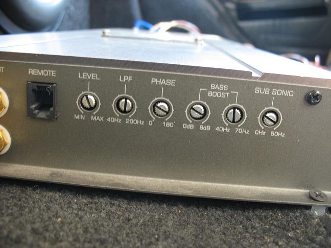

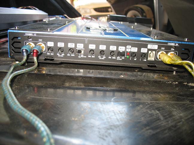

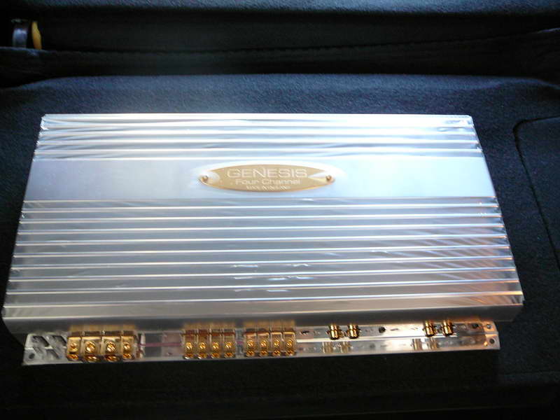

Amplificator: Genesis Series III - Four Chanel
Specificatii:
* Rated output per channel @ 4 Ohm (14.4V): 4 x 50 Watts
* Rated output per channel @ 2 Ohm (14.4V): 4 x 100 Watts
* Rated output per channel bridged @ 4 Ohm (14.4V): 2 x 200 Watts
* Typical output per channel @ 4 Ohm (14.4V): 4 x 95 Watts
* Typical output per channel @ 2 Ohms (14.4V): 4 x 145 watts
* Typical output per channel bridged @ 4 Ohms (14.4V): 2 x 290 watts
* Frequency response: 20-20KHz
* THD+ noise @ rated output: <0>100dB
* Input Sensitivity: .3V-5V
* Maximum current draw: 75A
* Dimensions (H x W x L) in mm: 62 x 210 x 360
Premii:
http://www.genesiscaraudio.net/awards/4chaward98lr.jpg
Difuzoare fata: Genesis Audiophile A16.01
Specificatii:
System type: 2 way component
Manufactured: Drive units, Hand made in Italy
Crossover, Hand made by Genesis in England
Frequency response: -6dB @ 65Hz & 22kHz , (27 litre sealed box).
Power rating: 80 watts RMS. Matching amp from 30 -100 Genesis watts.
Efficiency: 89dB for 1 watt @ 1 metre ( 92dB 2.83V @ 1metre )
Element sizes: 17cm / 6.5" bass/mid, 2.5cm / 1.0" silk dome tweeter
Premii:
http://www.genesiscaraudio.net/awards/audiophile16-review-hi-res.jpg

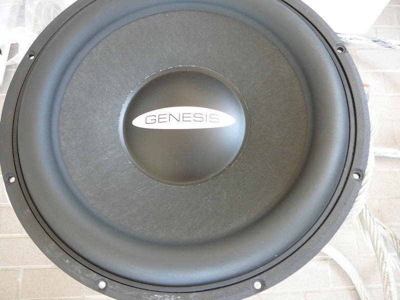

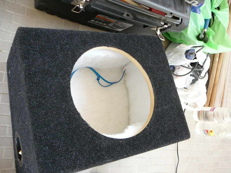

Subwoofer: Genesis Audiophile A30, incinta sealed.
Sprecificatii:
* Nominal Size: 12"
* Recommended Amplifier Power: 200-500 Watts RMS
* Sensitivity: 90dB/1 watt/1 meter
* Frequency Response: 20Hz-200Hz +/- 3dB
* Nominal Impedance: 4 ohms
* Mounting Depth: 129mm
Premii:
http://www.genesiscaraudio.net/awards/3001-review-lo-res.jpg
http://www.genesiscaraudio.net/awards/3001-award-lo-res.jpg

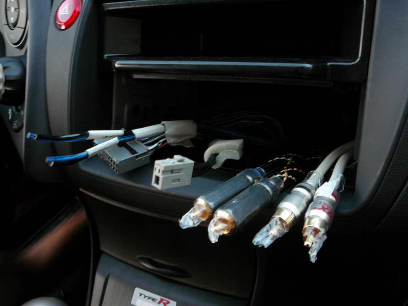

Conectica: Aurix
Materile fonoabsorbante: Standartplast (Bimast Standart + vibroplast M1)

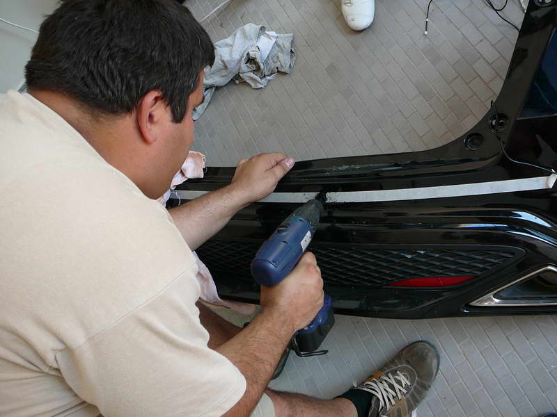

Asistenta parcare cu 8 senzori.
Worktime: aproximativ 20 ore

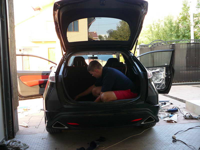

Special thanks to SHARKKY. Fara ajutorul lui nu stiu ce m-as fi facut.

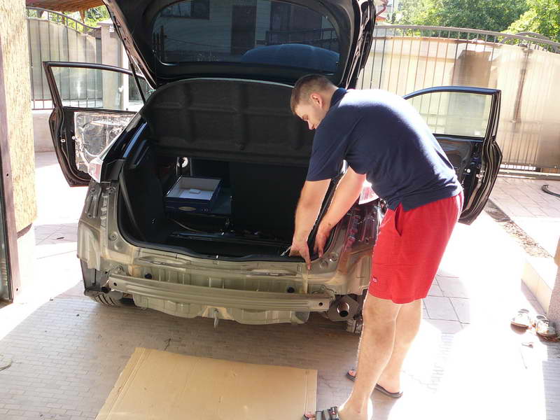

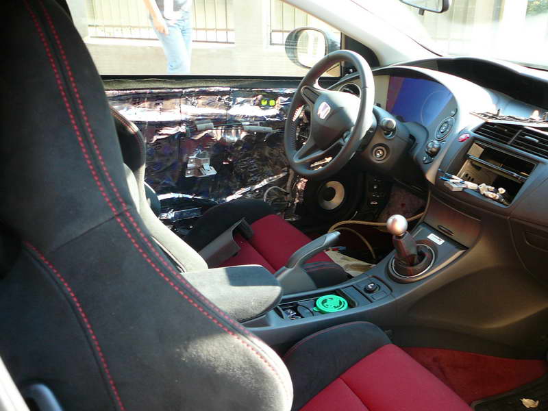

Urmeaza poze. Bineinteles ca la final, cand am vrut sa fac poza cu lucrarea terminata am observat ca nu mai aveam baterie la camera Smile. Oricum era ora 23, ieri noapte. Cu prima ocazie o sa urmeze niste reglaje si poze cu masina in starea finala.
Atasez si un filmulet. La prima proba a sistemului, cu statia nereglata, gain-urile la minim, o muzica mai linistia ( Dire Straits - The whispers of Dire Straits ), propietarul era nemultumit ca nu se auzea subwooferul. I-am spus sa astepte putin, am terminat de reglat statia, am scos un CD cu Prodigy si ... mai departe se vede in film Very Happy Cool

o&g
Data înscrierii: 12/Aug/2006
Mesaje: 2761
Locație: alba-iulia
MesajTrimis: Sâm Iul 28, 2007 3:55 pm    Titlul subiectului: Răspunde cu citat (quote)
auuuu ce masina...
tu ai mochetat incinta ?
ti-a iesit fain.

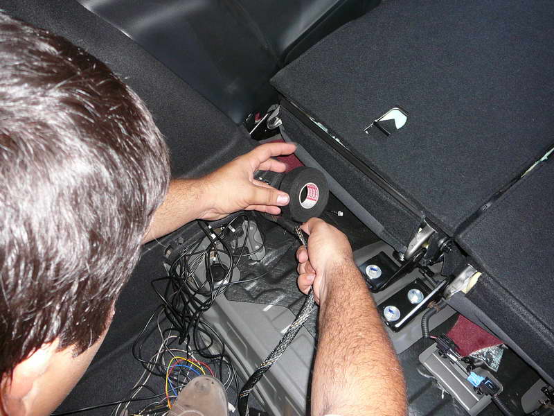

MesajTrimis: Sâm Iul 28, 2007 3:57 pm    Titlul subiectului: Răspunde cu citat (quote)

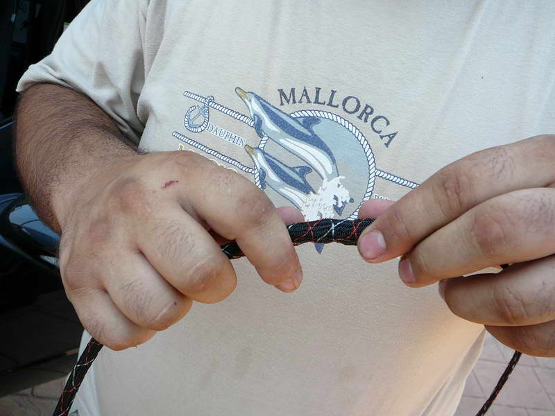

cine are rabdare, sa bage 2 metri de tresa pe un cablu Smile)
cablul sa fie cam de diametrul maxim care poate intra in tresa. Un adevarat test al nervilor Smile)
